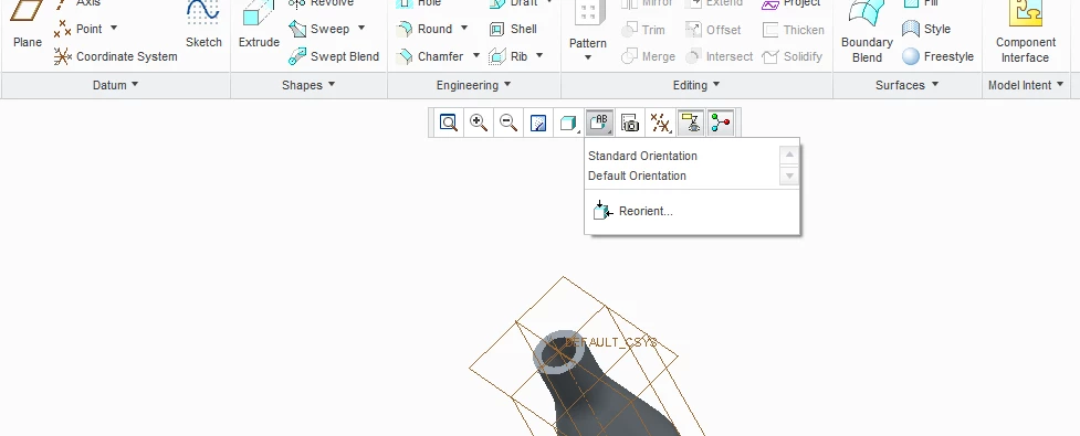

It has been a while I started using Creo Elements 2.0 with which I had worked a lot of modelling and designing. The problem that I am currently facing is, I can see basic views no more. I have attached a copy of the image as attachment. Please do help me out with this bug. I have lots of projects models to do in University. I request you to solve this issue.
Regards
Purushottam Kanchi
    June 27, 2013
    It is Creo Parametric that you are using. The problem is the model you have was not started using one of our template models.
    I would suggest you exit Creo, browse to "C:\Program Files\PTC\Creo 2.0\Common Files\M###\creo_standards" (### represents your build code number) and use the batch file named configure to select a unit system and drawing standard. This will ensure you are using a good template model for your parts, assemblies and drawings.
