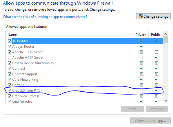

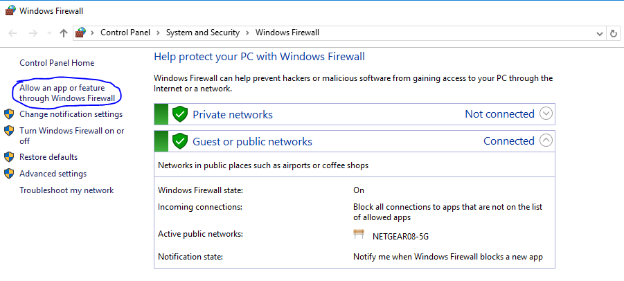

    SOLVED:
    I found a solution. . It has been a long time since Creo, the last few years. I got Creo 2.0 M130 to work on my Windows 10 computer. I would get the error message "Creo Parametric is shutting down because it is not possible to run the Quality Agent, which is required in this edition." If you call Technical Support for this problem, report error 0x0000000b. " I've gotten so a lot of the error message before Benthic, usually with a different error code.
    "Creo 2.0 from PTC" through the windows firewall. Here's how I did it:
    1. Close out all PTC applications.
    2. Type "Windows Firewall" into the windows start menu, or open Windows Firewall through the control panel.
    3. Click "Allow an app or feature through Windows firewall" on the left-hand side
    4. Click "Change settings", and scroll down and check the box next to the name "Creo 2.0 from PTC".
    5. So make sure to check the appropriate box on the right side of the line to allow access to private and / or public networks.
    6. Hit Okay, and try to start Creo Parametric.
    This work for me, I hope it works for you.
