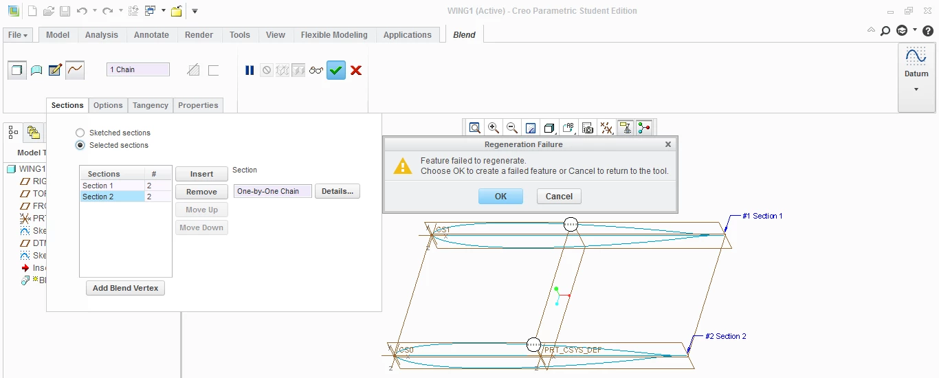

I created a section of airplane wing from two sets of co-ordinates (top of wing and bottom of wing). Then, I imported this sketch of a wing into a part file in two separate planes. I then tried to blend the two sketches together but it failed to regenerate?

    There were a number of problems.
    No trajectory. A straight line between the two sketches
    The sketches has overlapping geometry at the trailing edges. I dragged points slightly so they now shade in when the blue arrow is active.
    There was a chord line in each profile sketch which I changed to construction.
    Working file attached.
