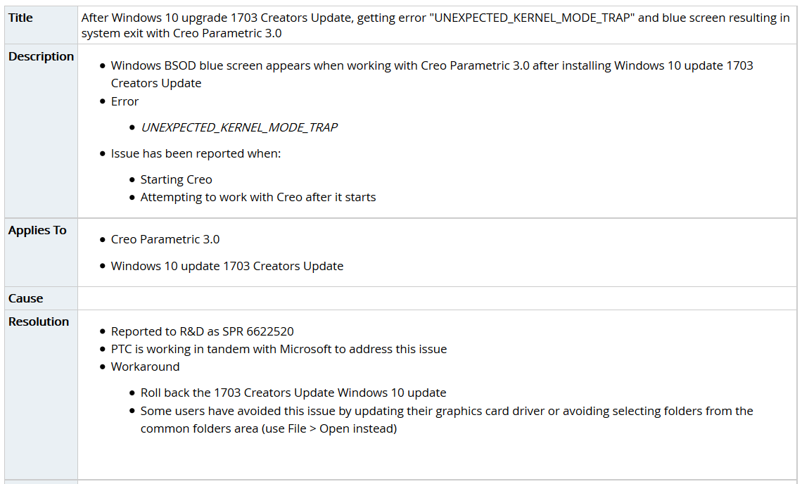

we are a group of students from Germany who need Help.
Since 2 weeks we are not able to start creo parametric 3.0 M110 in Windows 10.
The Start-Window of creo appears, we click on "Open" or "New" and then creo freezes and some secends after that a Windows Blue Screen appears with the code: Unexpected_Kernel_end
I have already tried:
-reinstalling creo
-disabling all antivirus and firewall software
-performing windows update
-added all to exceptions in antivirus
Thank You for Your Help.
    Best answer by MartinHanak
    there is no solution available.
    MH
    May 12, 2017
    MH
    fgerlach1-VisitorAuthor
    May 12, 2017
    What  is meant  with:  "avoiding  selecting folders from the common  folders  area "?
    May 12, 2017
    maybe this means ... avoid opening files from integrated browser.
    MH
