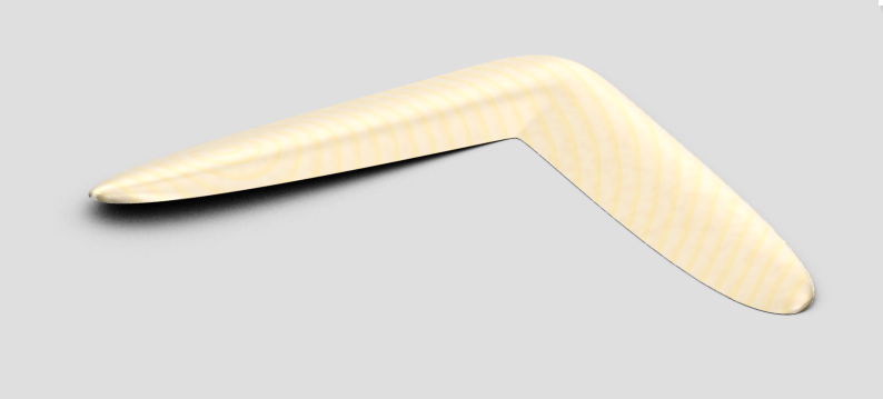

This set me thinking whether the Freestyle tool in the Creo suite of 3D modelling software could be used to model a boom? I was amazed how easy it was! Less than ten minutes is all it took to create a shape that could be CNC machined which should fly well and 'return to sender'.
Experts will probably point out things I missed or got wrong but this quick model clearly shows how quick and easy it is to model shapes like this using the Freestyle tools in PTC Creo.
