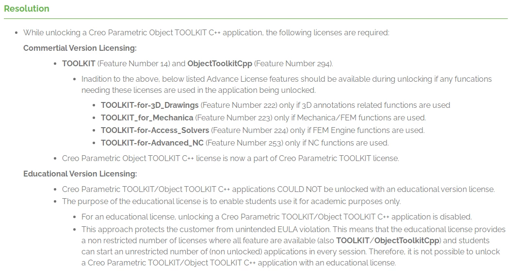

can educational version license uses Creo Parametric TOOLKIT/Object TOOLKIT C++ applications?
Hello. the educational license provides a non restricted number of licenses where all feature are available (also TOOLKIT/ObjectToolkitCpp) .but  Creo Parametric TOOLKIT/Object TOOLKIT C++ applications COULD NOT be unlocked with an educational version license.can educational version license uses Creo Parametric TOOLKIT/Object TOOLKIT C++ applications?
Sep 24, 2021 5:59 AM UTC
Read this article - "Information on Licenses needed for unlocking a Creo Parametric Object TOOLKIT C++ application": https://www.ptc.com/en/support/article/CS125183
And another one - "Unlocking a Creo Parametric Object TOOLKIT C++ application requires TOOLKIT-for-3D_Drawings license even though no API with additional license requirements are used": https://www.ptc.com/ru/support/article/cs256747

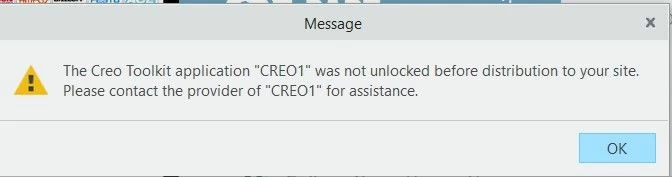

Is the educational license can not install auxiliary application ?
Sep 24, 2021 10:50 AM UTC
Is there any other way to run auxiliary applications in the educational license?
Sep 3, 2026 3:08 PM UTC
  1. Applications using one of the free (as in “useable without extra money”) Creo Parametric APIs (Java OTK free (f.k.a. JLink free), VB/.NET COM, WebLink/Creo.JS) should work with every Creo license.
  2. So should every unlocked auxiliary applications that use a paid Creo API (for unlocking, someone requires a non-free (paid) Creo developer license).
Only the developer licenses allow using locked auxiliary applications (and unlocking).
Note: there are subsets of API functions that require additional developer licenses (e.g. TOOLKIT for Mechanica, TOOLKIT for 3D Drawings).
This is due to PTCs license/price policy for auxiliary applications and the more powerful/extended APIs.
