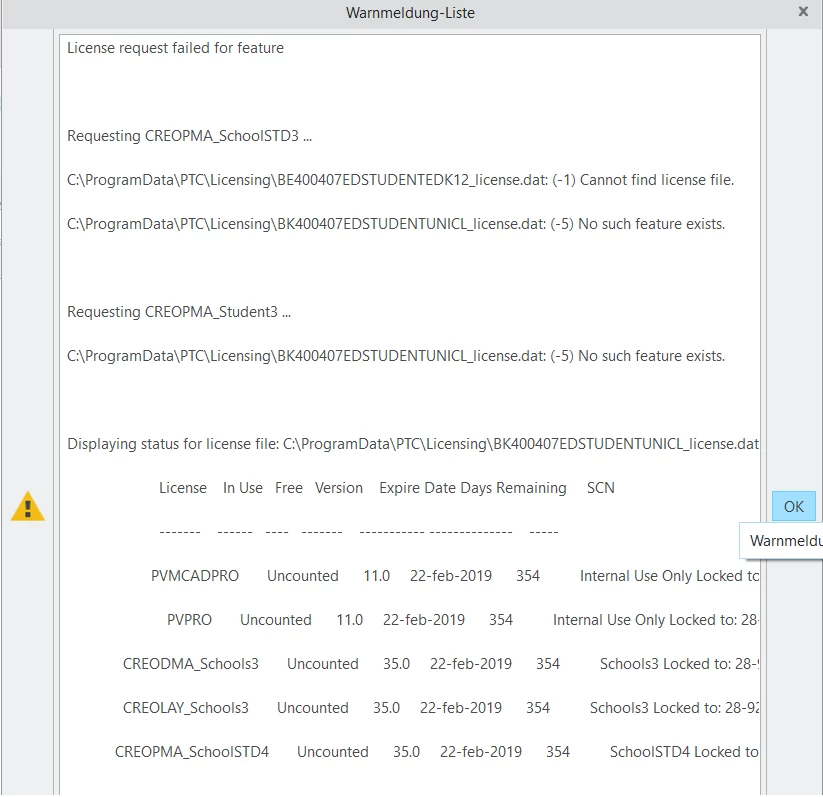

Pfad.pngWarnmeldungsliste.pngI ran the normal licensing process like its described in the pdf file you get after downloadig the creo 4 version for students.
When i open creo 4 it shows me the error attached (second picture).
Where did i fail during the installation?
Thank you for helping me out 🙂

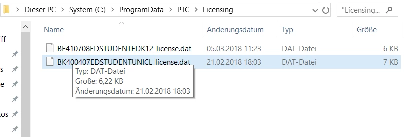

if you want to use Creo 4.0, then
  • uninstall all Creo 4.0 items
  • remove installation directory, if it still exists
  • remove all license files from C:\ProgramData\PTC\Licensing directory
  • launch setup.exe from Creo 4.0 installation media
  • enter Product code
K-12       students can use Product code BE410708EDSTUDENTEDK12
University students can use Product code BK410705EDSTUDENTUNICL

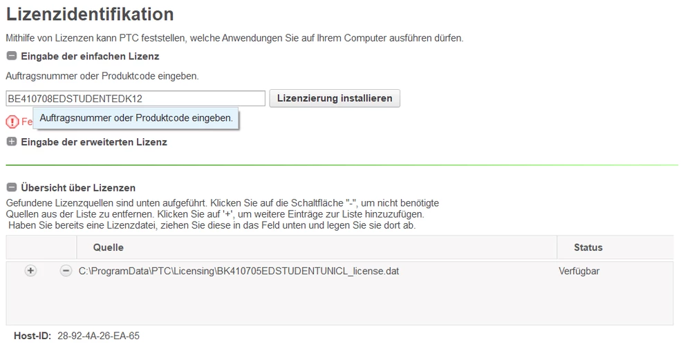

Now I cant install the Licence at all ?
March 7, 2018
I do not understand, why you are entering Product code BE410708EDSTUDENTEDK12 in situation when you have valid license file for Product code BK410705EDSTUDENTUNICL.
