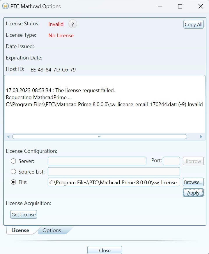

Hey! I bought the 1-year student license (PTC Prime 😎 this week, but I can't activate it. License request failes. See screenshot.
What do I do?

1.] What Host ID is included inside license file ?

The host ID don't match

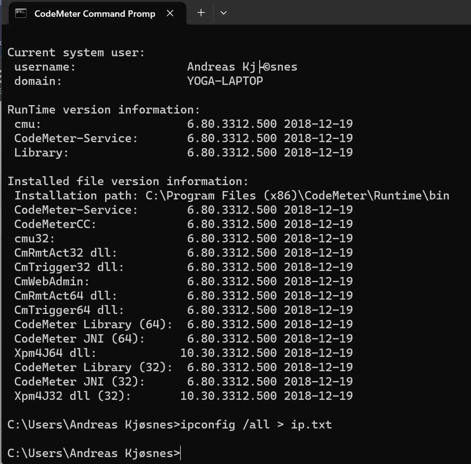

it look like you do not understand me. Just do following steps:
  • open Command prompt window
  • inside the window type ipconfig /all > ip.txt and press Enter
  • the command creates ip.txt file in directory shown in Command prompt window prompt
  • ip.txt file is text file ... it can be opened in Notepad

Sorry, I don't get it. I've typed the command and pressed enter but nothing happend.
the command created ip.txt file in MartinHanak_0-1679045217419.png directory.
