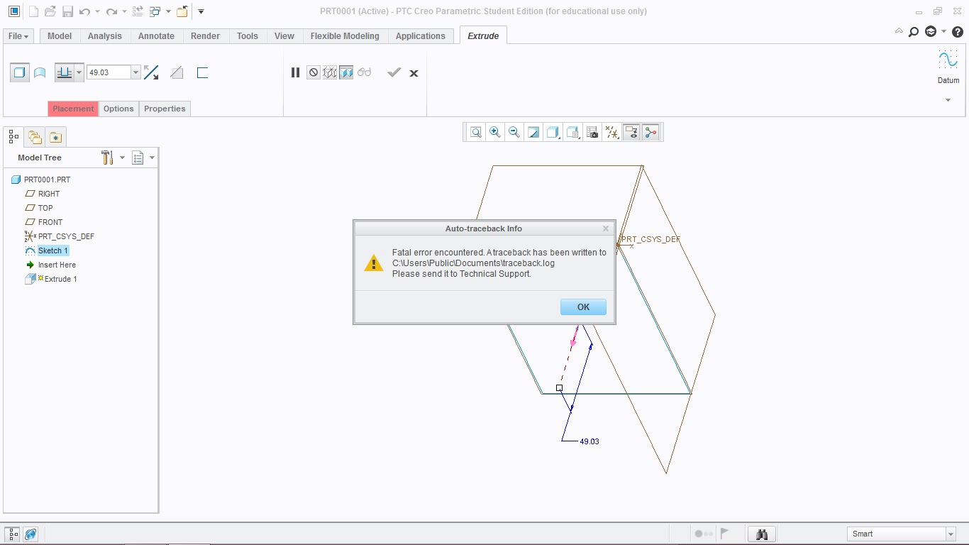

I can just sketch a model on the PTC Creo 3.0 version but can't seem to perform basic functions like Extrude, fillet, trim and so on.
This is the error I always get.
Kindly help me sort this issue.

    What computer, Operating system, graphics card?
    Has another version been installed and overwritten?
    January 23, 2015
    Lenovo G510 laptop, 4th gen i5 processor with 8GB RAM, Intel 4400 on board graphic card.
    This is the first and only version of PTC Creo 3.0 on my machine

    Try the graphics config option to "win32_gdi" as in:
    graphics win32_gdi
    January 24, 2015
    Harsh,
    download, unzip and put config.pro file into your startup directory.
