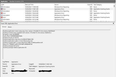

I am having the exact same issue and have found no answers. When I attempt to run the "setup.exe" file, a popup appears asking if I will allow the app to make changes. Then, nothing. I checked the windows event logs and found an error, as posted in the picture below. Still no answer. I have tried re-downloading the zip file directly from the website multiple times. I genuinely have no idea what to do.

just to be sure, try removing the space from the directory name. Then run setup.exe again
  • for example: change C:\Creo Setup to C:\Creo_Setup

I sincerely appreciate your help, and I actually JUST tried this. Still no dice, even after deleting all files, redownloading the zip file, extracting into the newly named PTC_install file, right click run as admin, nothing. I get the popup asking if I would like to let the ap make changes, I say yes, I get the little blue circle cursor for a few seconds and poof.
