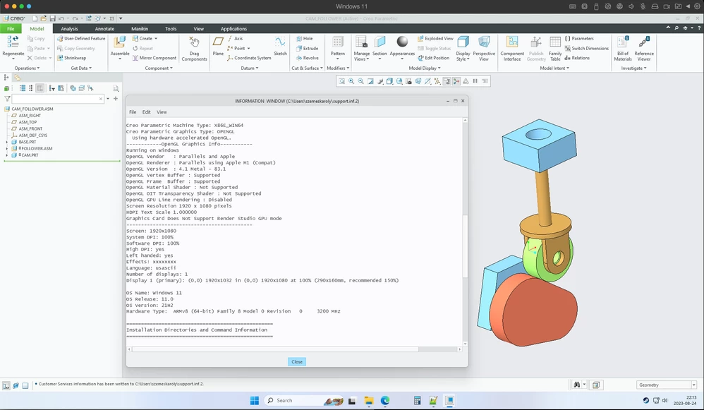

Aug 24, 2023 8:23 PM UTC
You can run Creo 10 (or earlyer version) on Mac M1 with Parallel Desktop 19.
Edit C:\Program Files\PTC\Creo 10.0.1.0\Parametric\bin\parametric.psf and add this line at the start:
ENV=PRO_MACHINE_TYPE=x86e_win64

Aug 25, 2023 8:14 AM UTC
Information source ...
https://www.parallels.com/eu/products/desktop/whats-new/
Note: I am almost sure that PTC does not support this environment.
11-Garnet
Aug 25, 2023 8:34 AM UTC
Yes It is not supported by PTC but It works. 🙂
