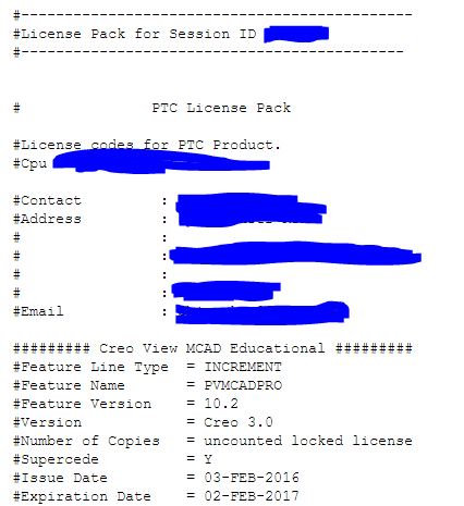

This is the message I get when I open Creo programs, but I can't figure out how to license it. I have done this before but it always worked just fine when I downloaded it. I can't find any product code, the only thing I managed was to find was an email that contained a file. Here is a bit of the file so you know what I'm talking about:
I don't know how to get the proper licensing, and I'm on a time sensitive schedule. If you know anything about this, please help out. Thanks.

    Peter,
    Your license file looks fine. I would recommend completely uninstalling Creo, then reinstalling and making sure your antivirus and firewall are turned off before the install. Sometimes they can block files and cause issues for people.
    Let me know how it goes.
    Chris

    .Thanks. I just reinstalled everything and it worked fine. I decided to download the 32 bit version to see if it changed anything, but probably the full reinstall was all I needed.

    open your license file in Notepad and explore all INCREMENT lines. One of them is related to Creo Parametric (eg. INCREMENT CREOPMA_Student2). You can publish INCREMENT lines to enable me to give you exact information.
    Locate parametric.psf in Parametric\bin directory in Creo installation and open it in Notepad. Then locate the following lines and enter appropriate information in them.
    ENV=PTC_D_LICENSE_FILE-=full_path_to_license_file
    ENV=CREOPMA_FEATURE_NAME=CREOPMA_Student2 ()
    Save parametric.psf file and test launching Creo.
