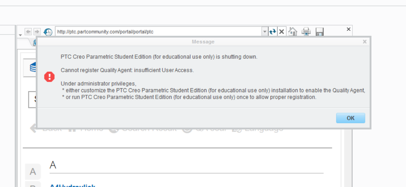

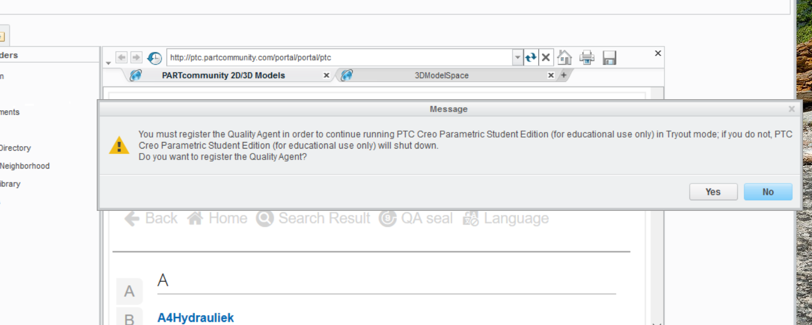

Every time I go to run Creo Parametric 3.0 these windows pop up and selecting any options shuts the program down immediately. Does any one know how to fix this?creo1.PNG

    Hi Michael,
    Can you try right-clicking on the Creo Parametric icon and selecting "Run as administrator"? Then click Yes to register the Quality Agent.
    Let me know if that helps.
    Chris

    Hey Chris,
    I was having the same issue Michael was having. I tried right-clicking and running it as administrator and that solved the problem for me.
