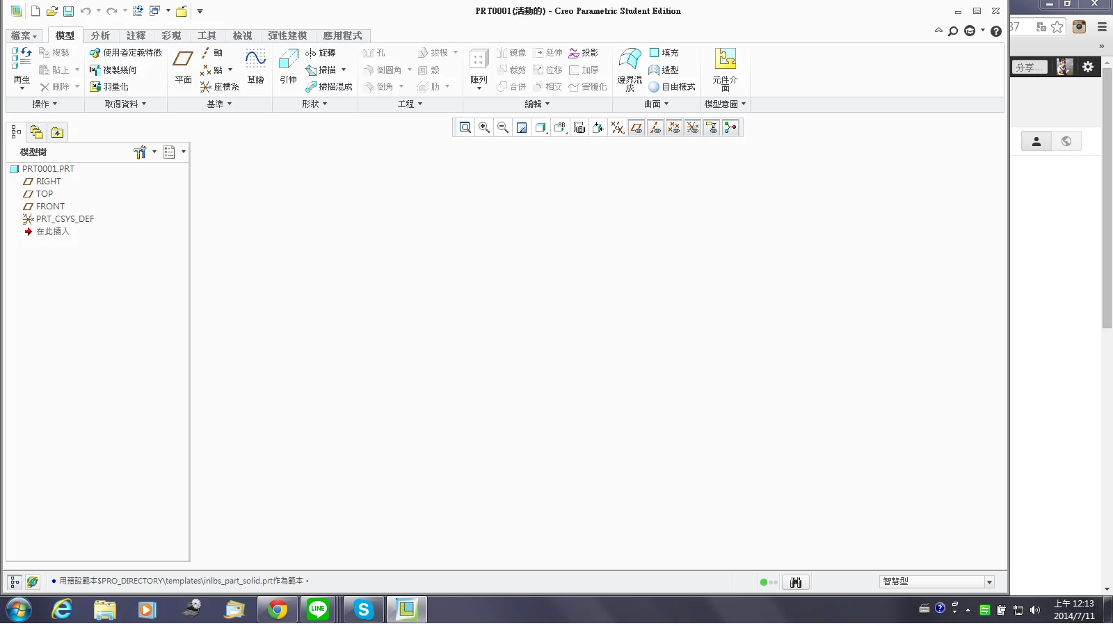

can't see any side on the sketch
after i download the creo2.0(for student) , i cant see any front or top or right one the screen, i check all the options, it all right , but i cant choose any side or sketch place , even i choose top at will , still cant sketch or do anything , i try to download again , but still the same , just like the photo i upload , that is i prt screen, hope someone can hlep me , it will grateful .

    This issue is caused almost always by out of date graphics drivers. Usually updating them should fix this right away.
    http://communities.ptc.com/videos/4255
    Above is a video on the topic, let me know if you have any questions. There are also other tricks we can try, so let me know if that does not work.
