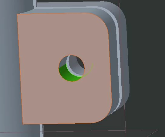

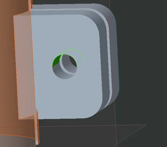

Hello I created a hole with extrude (remove material) option nut then I got 2 bottom surfaces of 2 holes as 1 entity and 2 top surface as 1 entity later I divided the 2 bottom and 2 top into 4 entity with split surface region option. Now I cannot unify the top and bottom surface for either of the holes. I need top and bottom as 1 entity for using analysis on another software (which does not support join surface and split surface are considered as 2 cad faces)

So now in the below images I want to join the both surfaces of the hole (highlighted in green) how do I proceed as I have tried unify tool but it is not highlighting anything
cylindrical surface of the hole is always split into 2 halves. You cannot unite them into single surface.

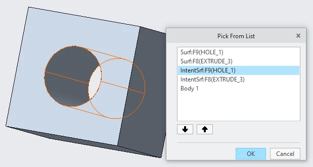

If the only problem is selection then you can use Pick From List command to select both halves at once.

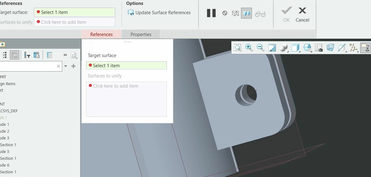

September 13, 2023
Ok now is it possible to join surfaces on the picture above. When I try using the unify surface option I am unable to select the surface either on the part or on the model tree
