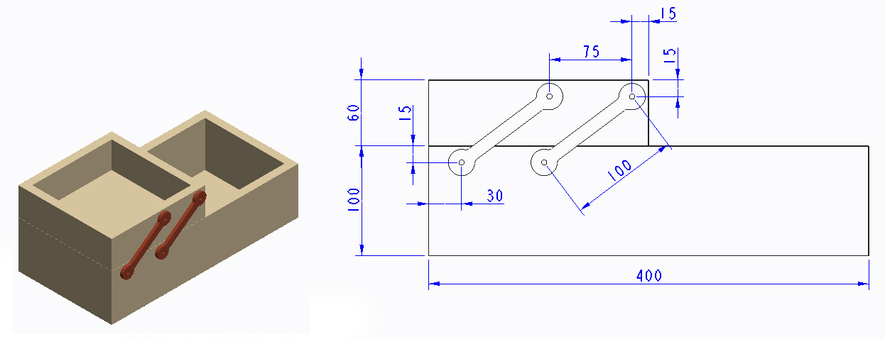

In response to a post in the Product Design Facebook forum, I created this proof of concept for a cantilever box.  The link geometry ensures the tray remains horizontal through the full motion.
