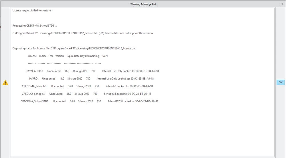

I was given the option to install Creo 6.0... After downloading the file and extracting it - i then ran the "Setup-school.exe" file.
After installing was finished i started the program and got the following pop up message.
Any help?
Best answer by Alex_Cazacu
1. Please set permissions to folder C:\Program Files\PTC\Creo 6.0.2.0 to max for your user.
2. Move the SW license to another location.
3. Run setup.exe (from the installation folder) and choose Reconfigure existing software from the installer.
4. Finish setup and it should be all fixed.
Alex
Any help?
Product code BE500806EDSTUDENTEDK12 belongs to Creo 5.0, you cannot use it to run Creo 6.0.
According to https://apps.ptc.com/schools/references/install_creo6_schools_standard.pdf you have to use Product code BE600908EDSTUDENTEDK12 for Creo 6.0 installation.
Also ... please read carefully instructions included in install_creo6_schools_standard.pdf.

I ran into this very same looking issue with Creo 6.
To fill in a few steps that may be relevant:
Preconditions:  The PTC accounts / licenses are for FIRST use, created via www.ptc.com/appserver/common/account/ptcacademic.jsp .  Already successfully installed Creo Parametric on other computers, using "setup.exe", not "setup-schools.exe", each time with a different PTC account, when prompted.  While using "setup.exe", there is an opportunity to provide the version 6 license key / product code.
Then on another computer, I tried to run the "setup-schools.exe" instead of "setup.exe" (just for fun, to see what was different), and I tried to use a PTC account that was already used during a successful installation** on a previous machine, because both machines belonged to the same person (me).  While using "setup-schools.exe", I did not see an opportunity to provide a license key / product code.  Instead, I was only prompted to provide a PTC account, which I did.  The setup process completed, but upon launching Creo Parametric, the "License request failed for feature" message appeared, with "Displaying status for... BE500..."!  On this machine with this account, nothing to do with PTC products nor Creo version 5 were ever used or selected.  So, maybe the issue stems from something in the PTC account that is configured to provide the version 5 license.
At https://www.ptc.com/en/support, I am unable to access the "Manage Licenses" area.  I get the message "Access Denied - Insufficient Privileges".  Subsequent attempts to re-perform the installation with "setup.exe", or to copy in the license file received via email, and to delete others from ProgramData failed to satisfy licensing checks for me.
At any rate, to avoid this problem, the solution might be:
1. Run "setup.exe" and not "setup-schools.exe", so that the version 6 key / code can be provided during installation.
2. Don't use a PTC account that was already used on another computer.
However, I do not know if this would avoid or resolve the issue.
**By "successful installation", I mean that the install steps completed successfully, following the two documents about installing and configuring, using "setup.exe" not "setup-schools.exe", and that license checks appeared to be successful during subsequent running of the installed and configured software.
