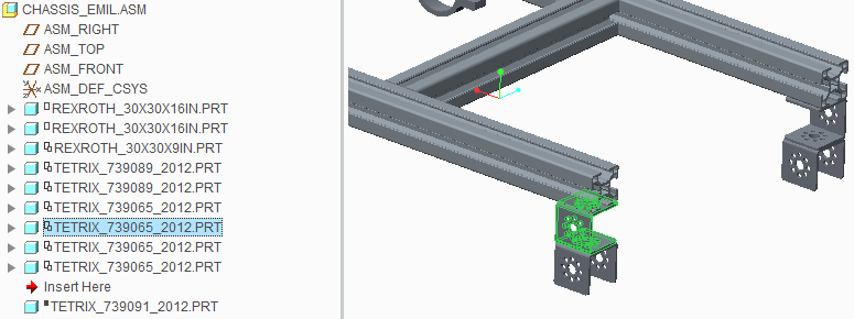

How does one control what parts and assemblies are visible when in edit definition with Creo Parametric 2.0? Oftentimes when having to re-lay out a Tetrix or 80/20 or Rexroth channel assembly when one highlights the one member the adjacent ones that I am trying to constrain to disappear. This disappearnace occurs from both the tree and from the workspace. If one selects "activate" all the other parts show up grayed out but "edit definition" is not available when a part is made active rather than the top tree structure. This behavior does not express itself with Creo Direct 2.0 which I have started to use for laying out the components but unfortunately does not give me the necessary granularity and control over constraints.

This effect also happens with 4 simple Tetrix Channels assembled in a rectangular fashion to form a chassis.

    Items are visible if they are defined earlier in the model sequence and will not be visible if they are defined later in the sequence than the component or feature you are redefining.
    You can change the order of the component or feature to a later location or move the items you want to use as references to be earlier than the one you are redefining by picking them in the model tree and dragging them to a new spot. This will also force items that must be earlier (moving up the tree) or must be later (moving down the tree) to be moved along with the item.
    The differerence between the two products is that Creo Parametric is a procedural modeler and Creo Direct is not, which means with Creo Parametric you are creating a program that starts with the first feature and procedes down the model tree to create the geometry. It's like any procedure in that a particlar step can't refer to the results of steps that haven't happened yet. Creo Parametric automatically removes those items you can't refer to when you redefine an item.

    David is right on with his explanation. If you use the Edit Definition action on the selected component, the two following it will be removed from the model tree and the display since they were added AFTER the currently selected component. You can move components up and down in the heirarchy of the tree, but you cannot move a component before any of its "parents". By parent, I am referring to any component added BEFORE this component used a reference to place the current component in the assembly.
    This is a good reason to use a structured assembly made up of multiple sub-assemblies. If you build the chassis as one assembly, you can add it to a new (higher level) assembly and then add additional components and subassemblies to it. This will give you a little more flexibility in the overall design and strucutre of the model.
