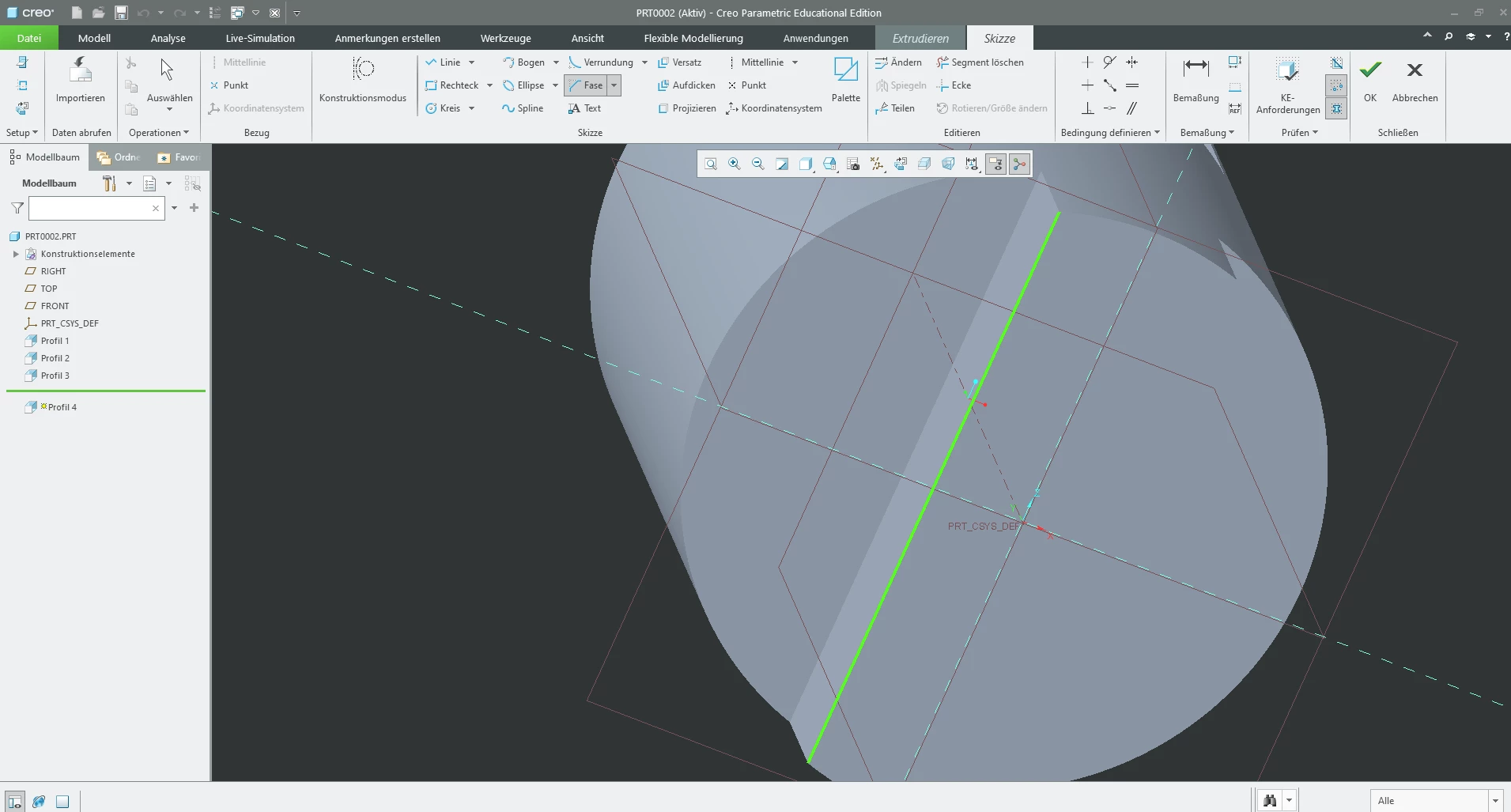

I´m trying to do a chamfer on my object but when I select the edge to modify it becomes green but i don´t get the option to modify the parameters of the chamfer.
Does anyone know why this is?
Best answer by MartinHanak
in Sketcher mode (2D) you cannot create 3D feature. See following picture.
