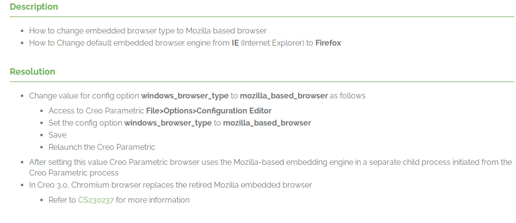

How can I change the default browser to chrome or Firefox ? I am not able to upload by generative study to cloud.
September 17, 2021
Read this article - "How to change embedded browser type to Mozilla based browser in Creo Parametric": https://www.ptc.com/en/support/article/CS54881
