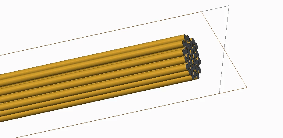

Hi guys,
for my master thesis I have to design a cable harness in detail, down to the braids of the cable. As the student license has no cabeling feature, it's kinda awkward.
So I thought about drawing a "master" cable with the sweep feature and I only import that same cable in my final assembly. Because every cable of the harness is different, I would have to adjust the stats (like length and curves). So I would like to ask you, how to adjust the axis of the sweep feature. It would be nice, if I can easily adjust the axis and keep the same profile (1 cable consists of 32 braids and it isn't funny to draw 0,2 mm circles for each cable again). Some axis has to be straigth but mostley they have different curves.
I think my problem is actually easy to solve but I really don't know how to adjust this feature. Right mouse click and "define" is not enough it seems...
Regards Tom

    Maybe this> Creo 3.0 Tutorial: How to create a Rope and Wires - YouTube
    The cabling feature is for managing routing, not accurate detailed depiction.
