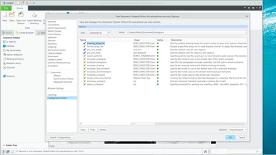

i am able to change my length,mass,tolerance and weld standard but I am unable to make the changes for template which I do they are not being retrieved if I close and open the app
config.pro options are applied when you create new empty model. If you want to use template, then you have to open it, modify its properties and save it.
