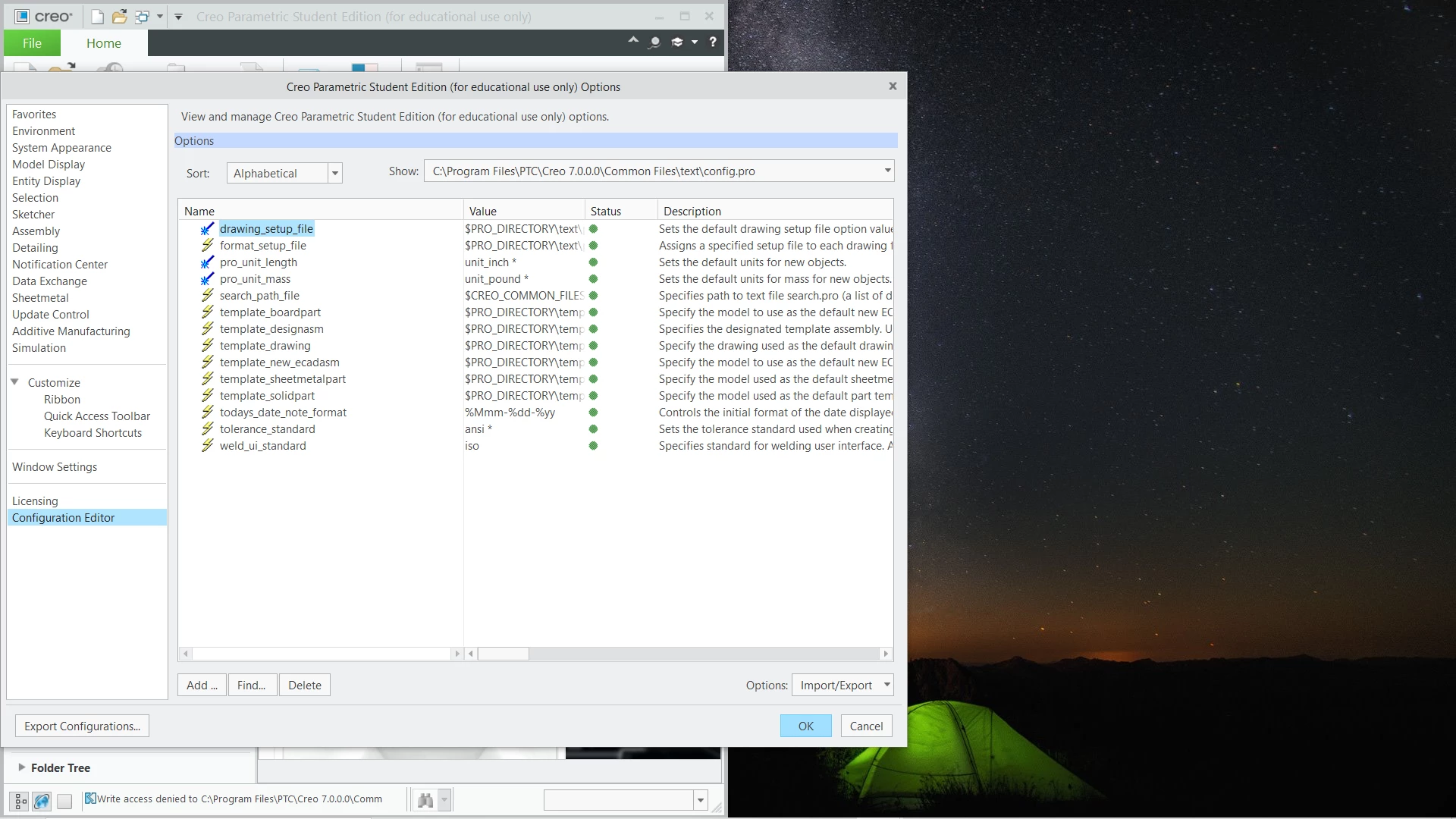

I changed my dimensions and file locations in configuration settings  if I close and reopen the software the configurations are reset how to save the configurations given to the software

config.pro file mentioned on the picture is default Creo configuration file. I do not know how did you modify its options and where did you save modified file.
