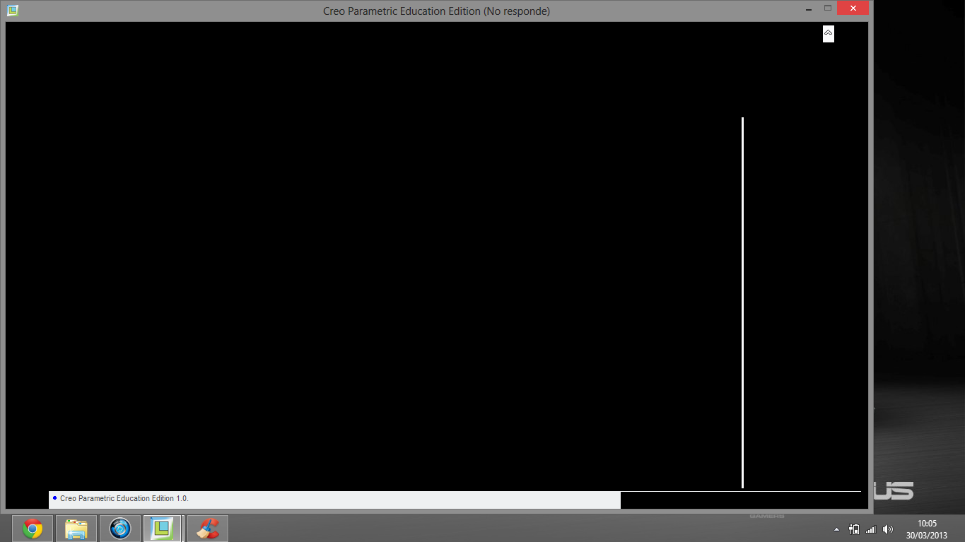

Well, my problem is i just got a new laptop,an Asus G55vw. installed Creo 1.0 and when i start the program it just shows the frame of the window, and then says it stoped working.
I have an nvidia geforce gtx 660m 2Gb
Windows 8-64bit
intel core i7-3610QM
12,0 GB RAM
Thank you very much
Any help is highly appreciated
Daniel

    Daniel,
    This is a graphics problem. Updating your graphics driver will most likely fix it (yes, even on a new computer).
    This post contains more details about various solutions and graphics options.
    Adam

    Indeed it was the GPU drivers, thank you very much for your help!
