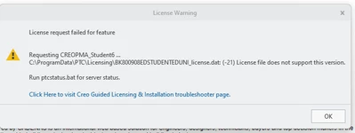

I am trying to install Creo 10 under a university student license. I have previously installed other versions, which I have uninstalled.
When I log in during the licensing part of installation, I get an error. The installer allowed me to complete installation, but now I am still unable to obtain a license.
When I open Creo, it says the license is not supported for this version.

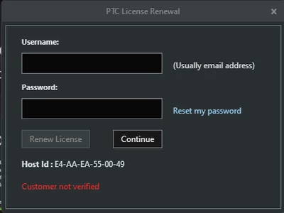

I then try to log in but get a "Customer not valid" warning:
What can I do to get the license working?
Thanks!

Take a look here - "Creo Student v10 free license": https://community.ptc.com/t5/PTC-Education-Forum/Creo-Student-v10-free-license/td-p/888631

1.] login to PTC to test whether you username+password is valid
2.] remove all files from C:\ProgramData\PTC\Licensing directory
3.] follow instructions included in https://apps.ptc.com/schools/references/install_creo10_unistudent_standard.pdf document.
