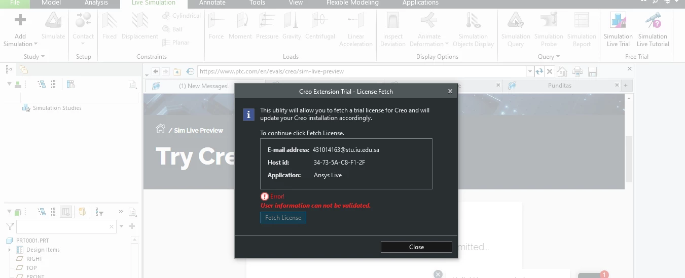

I have an educational edition Creo 11 when I trying to  make a live simulation I can't and I got this massage , any help?

Creo Student Free doesn't have Creo Live Simulation included. You need to use the University license for Simulation or purchase from the PTC eStore a Creo Student Premium license.
