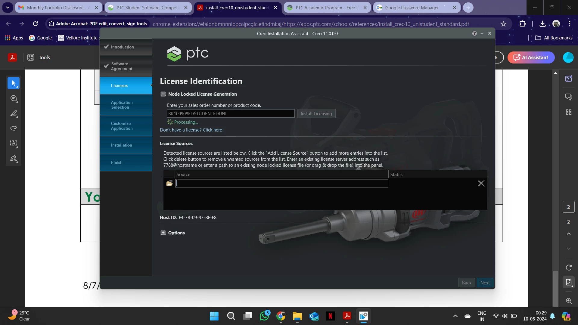

a lot of time is taking for processing, is it normal or is something wrong? I have attached the screenshot
Best answer by MartinHanak
you entered Creo 10.0 Product code.
Please enter BE110908EDSTUDENTEDK12

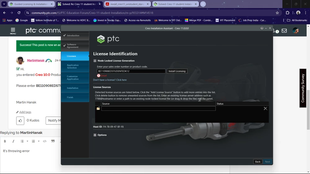

June 10, 2024
@SD_11123179 wrote:
option no.1
In File Explorer go to C:\ProgramData\PTC\Licensing directory. If it contains some files them move them to different directory.
C:\ProgramData\PTC\Licensing directory must be empty before you launch setup.exe.
Launch setup.exe.
option no.2
You can request license file via email. Please read https://community.ptc.com/t5/PTC-Education-Forum/Creo-Parametric-9-0-Student-Edition-Licence-error/m-p/897846 discussion.
