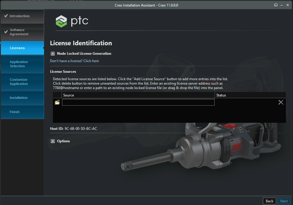

CREO 11 STUDENT LISCENCE ISSUE
I downloaded CREO 11.0 after making an education account but I can't find the actual licence file it is asking for at the start of the installation page?
I also clicked on the don't have a licence box and I couldn't upgrade my account either,
Please see screen shot attachment,
Any help on how to find a student licence file would be appreciated, Thanks Jason
October 11, 2024
during first installation you enter product code. You can find it in https://apps.ptc.com/schools/references/install_creo11_unistudent_standard.pdf document.
Installer download license file automatically and saves it in hidden C:\ProgramData\PTC\Licensing directory.
