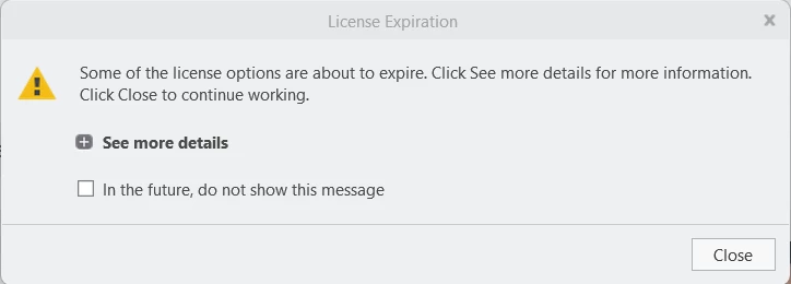

Hi, my student license for Creo Parametric 12.0 is going to expire. I see that on the internet, the message is supposed to have a 'Renew License' button with it, but that is not available for me. Please guide me.Screenshot 2025-09-14 081706.png

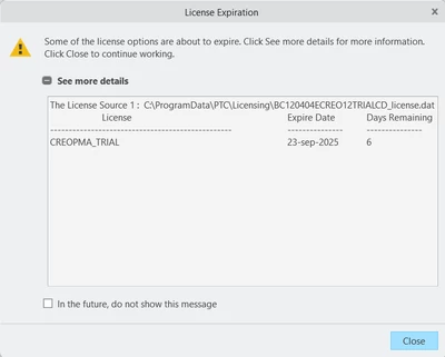

click + See more details button and publish License Expiration window once again.
Sep 17, 2025 5:49 AM UTC
When I click on See more, the following appears.
Sep 17, 2025 5:56 AM UTC
the TRIAL license is intended for time-limited testing. It is not a student license with a validity period of 1 year.
Please read following documents:
https://apps.ptc.com/schools/references/install_creo_schools_standard.pdf
https://apps.ptc.com/schools/references/install_creo_university_edition.pdf
