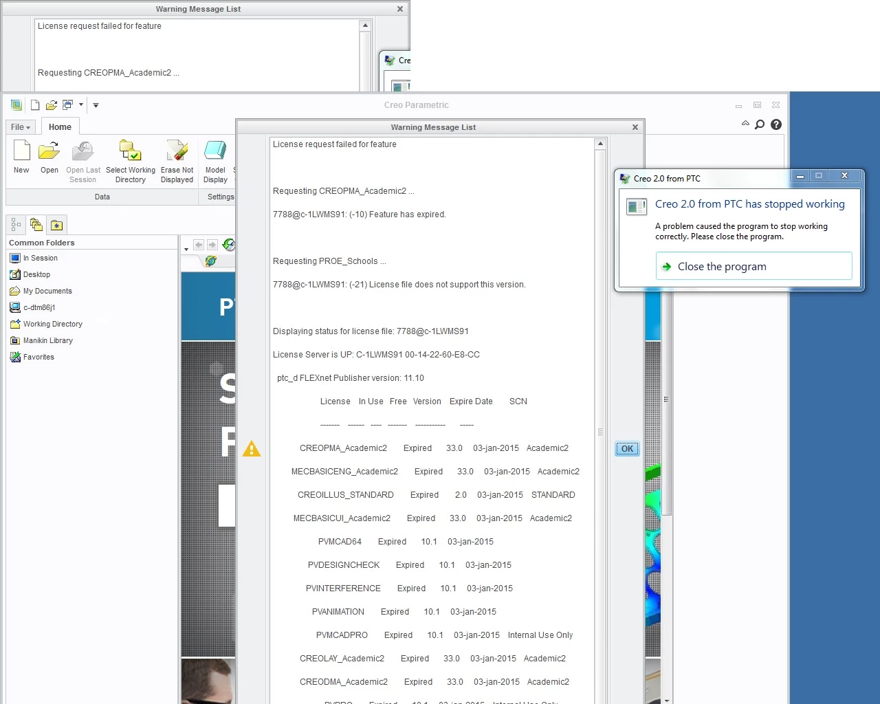

    Hi There,
    Our School has a license server install. Tried to start Creo 2.0 yesterday and window pops up and says something like license expired 3 Jan 2015, two days before school resummed after the break.
    Is there a way to extend the expiry?
    I am in the final days of the semester and students have no way to complete their work.
    Any advice appreciated. A new install would be prohibative since our Boards IT department will take some time to package the install to the 78 computers we use Creo with.

    January 12, 2015
    I'm in the same boat, and I think wer're going to need a new license file from PTC. I seem to recall that Mark is in Mountain time, so I'm hoping he'll see this soon
