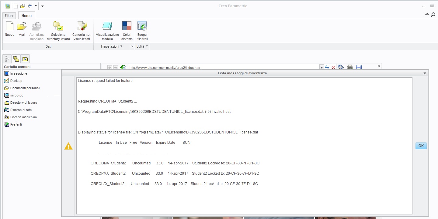

Hi everybody.
I'm using the Creo 2.0 Student version. Yesterday I installed Windows 10 on my computer (the previous operative system I had was Windows 7).
Until yesterday Creo 2.0 was working; after the upgrade to Windows 10 I got this problem: License request failed for feature.
I've already tried to do what written in http://apps.ptc.com/schools/references/support_reorder_network.pdf, but still I have this problem!
Is it possible to solve it even if I have installed Windows 10? What's the solution??
Thanks.
    Best answer by MartinHanak
    your license file is generated for network card with MAC address 20-CF-30-7F-D1-8C. You have to check if this network card is enabled and running.
