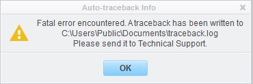

Hi there, I've been having a big problem trying to open creo on my laptop. I managed to install creo without a hassle, however when I try to open it, a window suddenly pops up that says:
Please help? i've tried re-installing Creo but this error still occurs.
My laptop Model: Inspiron 7520
Running on : Windows Home 7 Premium 64-bit (is it because of my operating system?)
Processor: Intel(R) Core(TM) i7-3612QM CPU @ 2.10GHz (8 CPUs), ~2.1GHz
Memory: 6144MB (6GB) RAM
If it's my operating system, do you think updating it to say Windows 8, will allow me to run Creo 2.0? Will updating it affect the fact that I have a locked license?
Any help would be much appreciated!

For any of those that may be looking at this post after the fact, an updated fix is available. Please see the below post for more information.
http://communities.ptc.com/thread/56357?tstart=0

For this issue I think it would be best if we were to takea direct look at that traceback log that was created. Could you please send an email to - and include the file that is being referred to in the error messsage?
Please let me know if you have any questions!

Hi
I also have problems with my version of creo; here is my traceback
The trace creation timestamp is: Fri Aug 29 23:32:51 14
The executable build timestamp is: Fri Feb 28 17:14:53 14
The datecode is: 2014000
The pro machine type is: i486_nt
The process ID is: 2092
The traceback type is : CRASH
Exception EXCEPTION_ACCESS_VIOLATION has occurred in the thread 2040.
