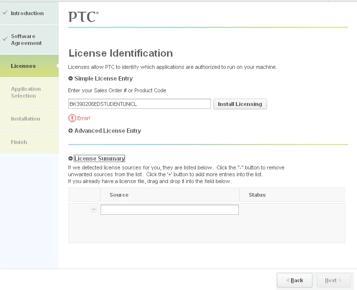

Hey guys! I really need to download creo 2.0 for students but it shows me an "error" message when i try to install it. Please help!

suggestion:
1.] install Creo 4.0
K-12       students can use Product code BE410708EDSTUDENTEDK12
University students can use Product code BK410705EDSTUDENTUNICL
2.] install Creo 2.0
Do not enter Product code, use license file created by Creo 4.0 installation in C:\ProgramData\PTC\Licensing directory.
