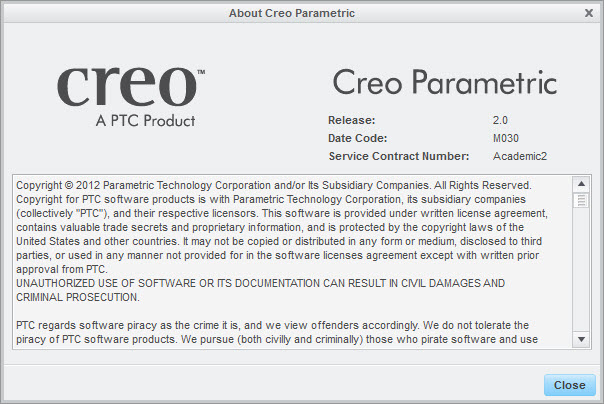

If you were one of the lucky ones who got a new machine for the holidays and it came with a shiny new copy of Windows 8, not to fear. PTC has you covered. The latest maintenance release of Creo 2.0 is M030 and it is fully supported on Windows 8. Stop by http://www.ptc.com/company/community/first/teams.htm to download new software.
If you're not sure which maintenance version you have, it is easy to check. Just start Creo 2.0 and pick File, Help, About Creo Parametric.

    I have been loading M010 and not the latest M030. Was told by PTC that M010 is fine too. Correct?
    Jan 21, 2013 7:09 PM UTC
    M030 is the first build code to be officially certified to be supported on Windows 8. Earlier versions (M010 and M020) will proabably work without issue but the are not officially supported.
    Note that in general, I have found M030 to be more stable that M010.
