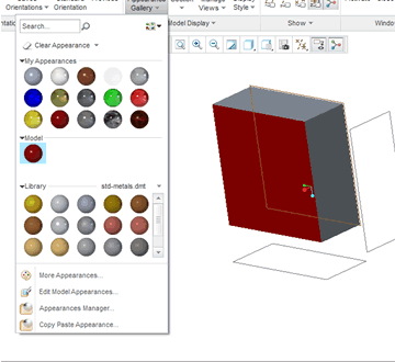

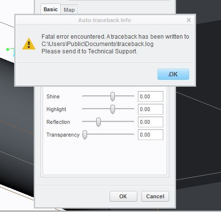

Whenever I go to render a part (change the color), and I click on appearance gallery, no colors appear. I then click on "more appearances", and the whole program freezes, gives me an error. and then closes out (see picture).
Any ideas what is wrong?

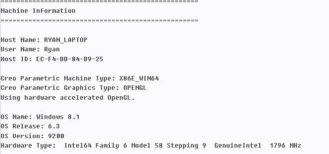

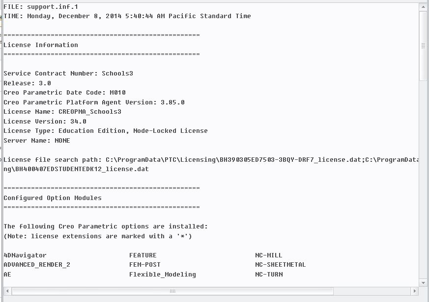

I attached the traceback log, since I cannot email support.

    Ryan, can you share the specifics of the hardware and the version of Creo 3.0 you're working with?
    rpackham1-VisitorAuthor
    December 8, 2014
    Intel i3 1.8 GHz
    4GB Ram

    Ryan, is the Appearance Gallery always empty? I have Creo 3.0 M010 also, but I am not getting the same error. Do you have the schools configuration installed? That does provide a custom color map. Also, does this happen for all models and all sessions of Creo or is it unique to a specific model?
