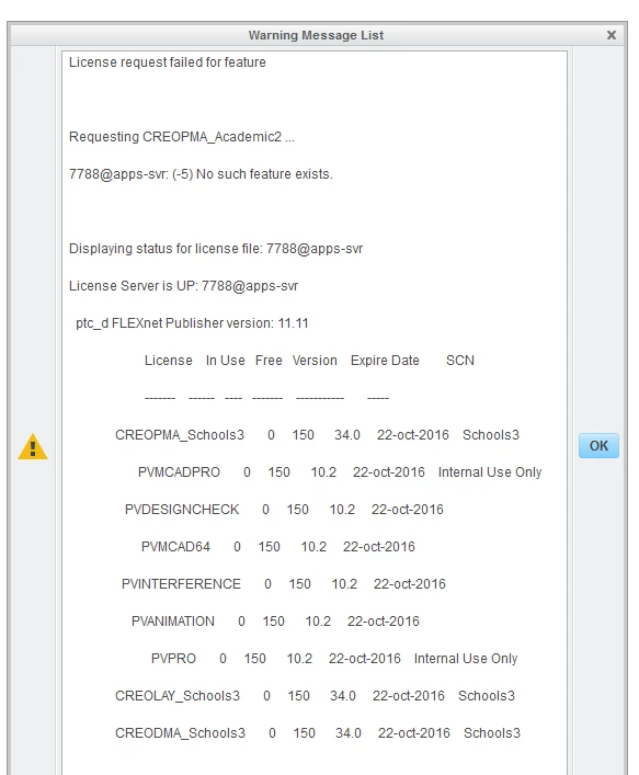

Creo 3.0 doesnt work, licensing server error
We installed the licesing server as per PDF instructions
We installed each client PC as per instructions.
When we launch the client we get a "License request failed for feature".
PLease can you offer any advice.. Attached is the error message

    Hi Mark,
    I have fixed it myself.
    On each client check the parametric.psf (c:\Program Files\PTC\Creo 3.0\M010\Parametric\bin) and change the following line:
    ENV=CREOPMA_FEATURE_NAME=CREOPMA_Academic2 ()
    to
    ENV=CREOPMA_FEATURE_NAME=CREOPMA_Schools3 ()
    Save the changes all the software should load. Please also note that if you use Layout,Direct or Simulate, you will also need to change their PSF file replacing Academic2 with Schools3 like above.

    Andrew,
    It appears that the license file that it is trying to reference is a Creo 2.0 license file. Can you please submit a support request so we can resolve this off the community?

    This 'first release' of Creo 3.0 for academic users is the single seat 'Student Edition'. The universal code in the install instructions will not work on a license server.
