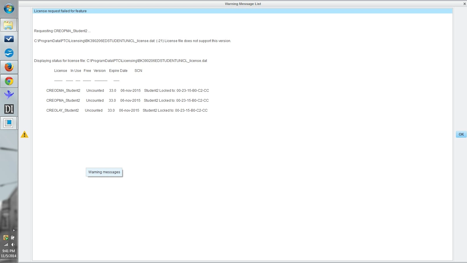

I've installed creo 3.0 using a student licence. When I start Creo, a warning message (screenshot attached below) prevents the progam from running. Licence does not support this version. Is there an older version available for student download?

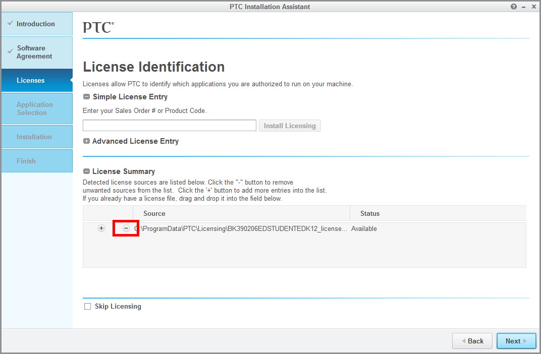

    Hi Joanthan,
    It is likely that you have both the Creo 2.0 and Creo 3.0 licenses running at the same time. Please try reinstalling Creo 3.0 but on the licensing step, make sure that all existing licenses have been removed from the License Summary box (see below).
    Once license summary is empty, then type in the product code into simple license entry and click install licensing. After that just follow the directions and you should be all set!
    Let me know if you're still experiencing issues.

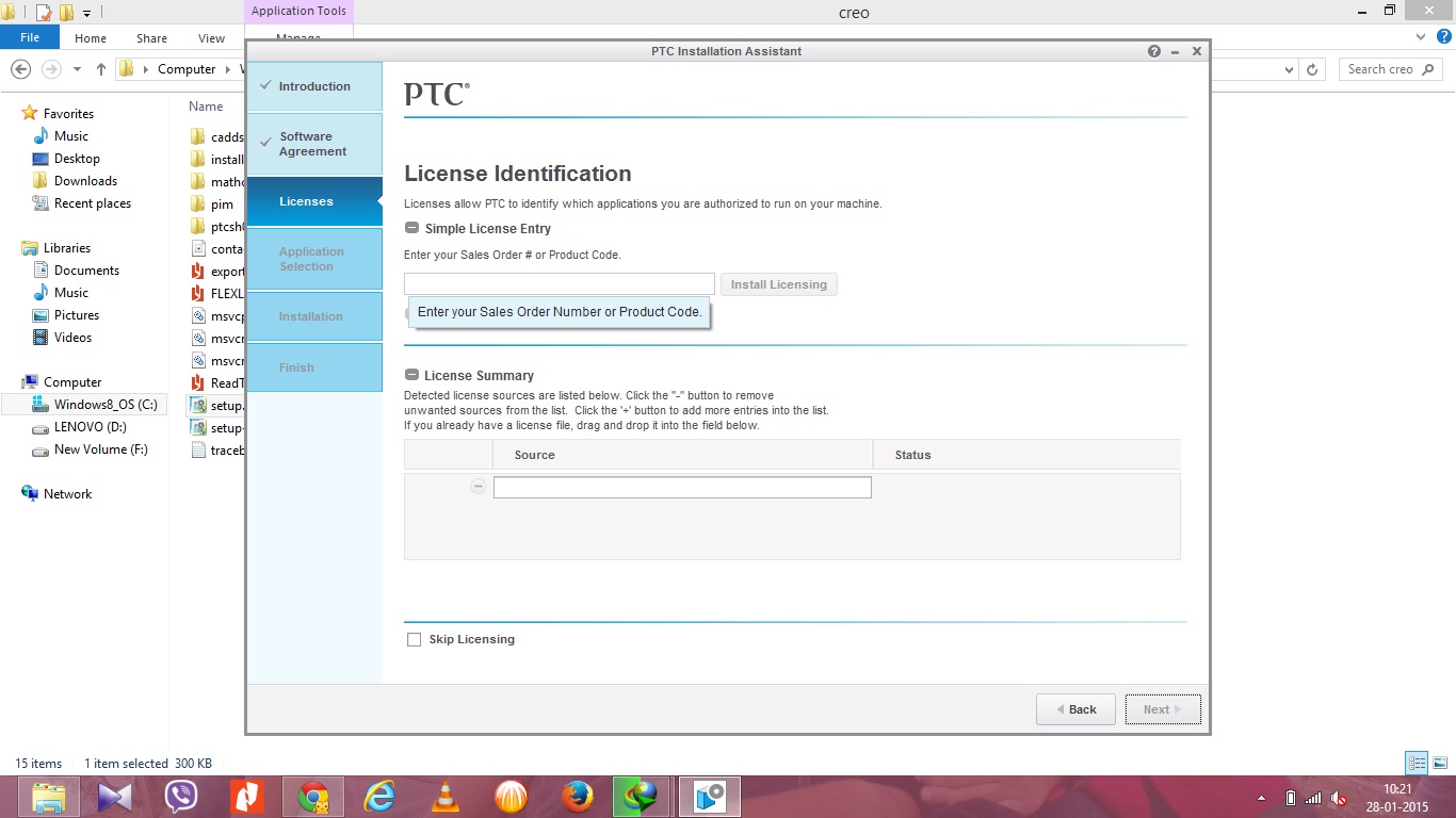

    hello sir,
    I am having a problem with the installation of student version of creo 3.0.I am not getting any cursor over the box where I am supposed to enter the student license.Please help me out.creoerror.jpg

    You need use the trail instalation in the zip folder, I did it, and I don't have any problem

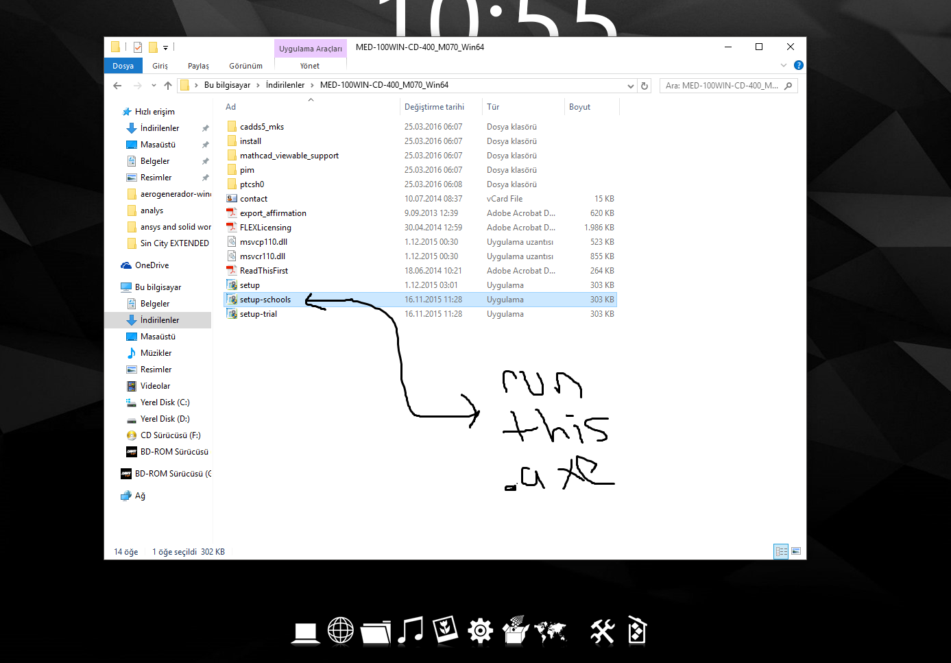

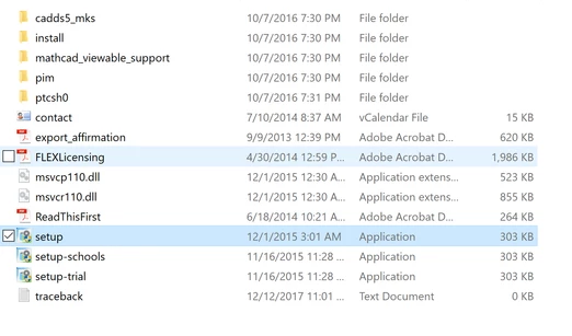

    i have solved this problem: let's go try agaia.
    there are a lot of setup in "MED-100WIN-CD-400_M070_Win64". we should run "setup-schools.axe" . if you run "setup.axe" you will have a problem. that's all.

    I am from India and here the students licenses are working in CREO 2.0 only. So till date the students product key is only supporting CREO 2.0. I dont know when does will it be in effect for CREO 3.0.
    So better dont waste your time to install student license for CREO 3.0 it will not work.
    The reason is very clear. As per the image you have attached contains detail of version which is 33.0. and this stands for CREO 2.0. For CREO 3.0 version should be 34.0.
    So, the conclusion is there is no availability of CREO 3.0 Student license till date.

    No, it's working in Creo 3.0 . ı had same problem but ı have just solved this problem. ı guess everyone ran setup.axe but you should have run setup-schools.axe . ı have solved by doing so

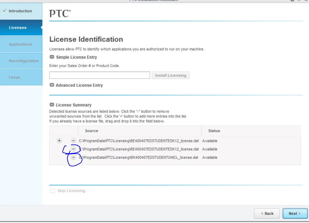

    December 12, 2017
    First start up "setup" application; select "reconfigure existing software"; remove all but one license source by selecting the minus button. Finish by letting installation assistant reconfig. TA_DA!
