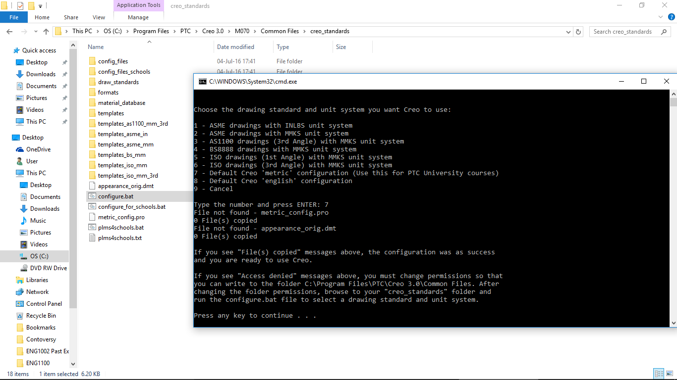

Hi there,
Just installed Creo 3.0 (Academic) in Windows 10.
Our course requires us to set-up Creo 3.0 in metric unit configuration. But when running the configure.bat and choosing option 7, I get error messages saying the files are not found???!???
Yet, you can clearly see from my attached picture that the files do exist.
What do I need to do to solve this problem?
(And, yes, I run it as administrator, so there is no problem with permissions).
I appreciate your adviceerrror.png.
- Joe.

    try manual configuration (backup original files before replacing them).
    look for C:\Program Files\PTC\Creo 3.0\M070\Common Files\text\metric_config.pro
    copy it to C:\Program Files\PTC\Creo 3.0\M070\Common Files\text\config.pro
    look for C:\Program Files\PTC\Creo 3.0\M070\Common Files\creo_standards\config_files\appearance_orig.dmt
    copy it to C:\Program Files\PTC\Creo 3.0\M070\Common Files\graphic-library\appearances\appearance.dmt

    Thank you Martin.
    That solved the problem.
    Much appreciated.
