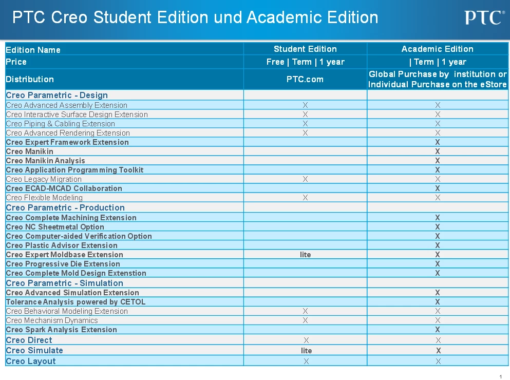

I need urgent help with Creo 3.0 Student Edition. I am a student at Friedrich-Alexander University Erlangen-Nuremnberg in Germany and downloaded, installed and registered correctly the software so far. For my master thesis I need to make a 3D-draft oft two cable harnesses. According to your website Creo 3.0 should be able to do that.

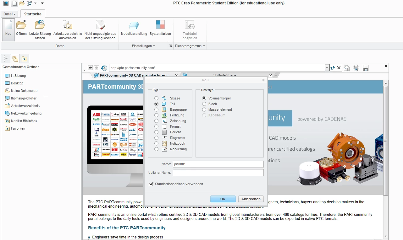

But after I have started the programm, I can only choose a new draft type of (volume corpus, sheet and mass element). Cable harnesses are written in grey (please see attachment), so I can t select it.
What can I do to choose that type? I ve downloaded the correct license from my university, there was only one. And that was automatically created during installation/registration.
