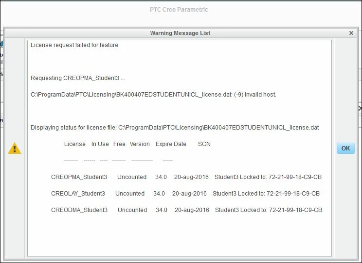

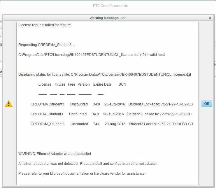

I then went to use the software a couple of days later and was denied access due to License Request Failure messages. Refer to attached screen shots (shown for PTC Creo Parametric, but also typical for Simulate, Direct and Layout applications)...

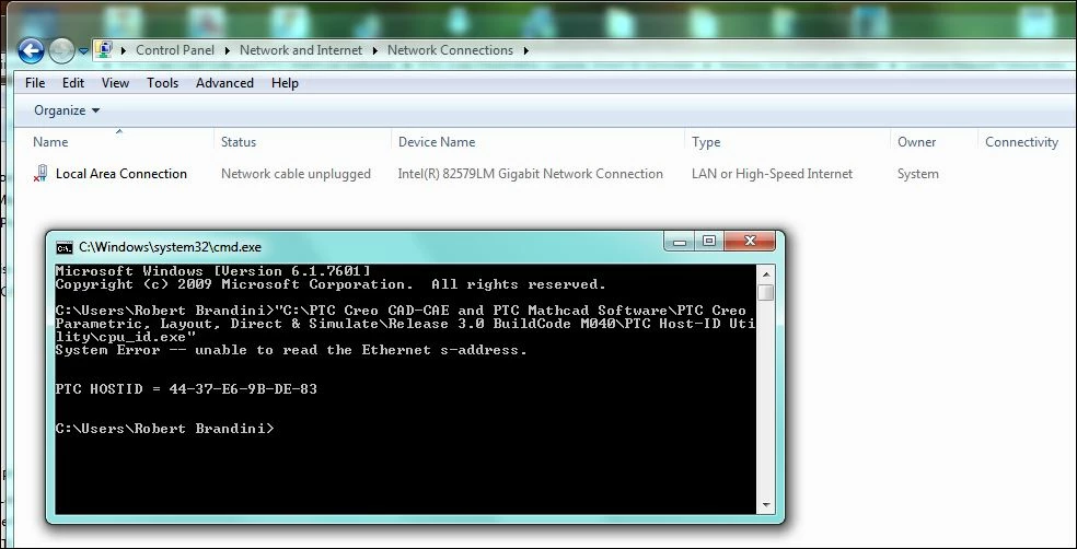

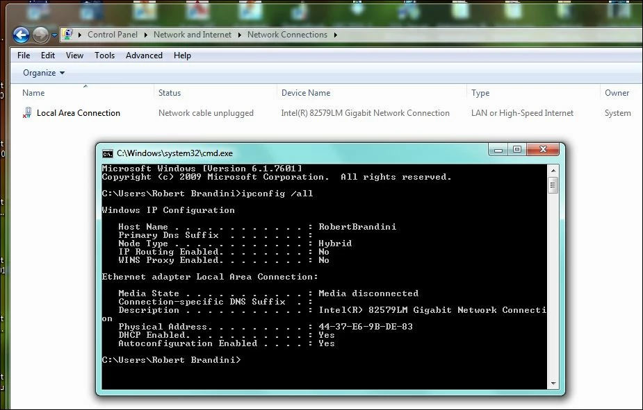

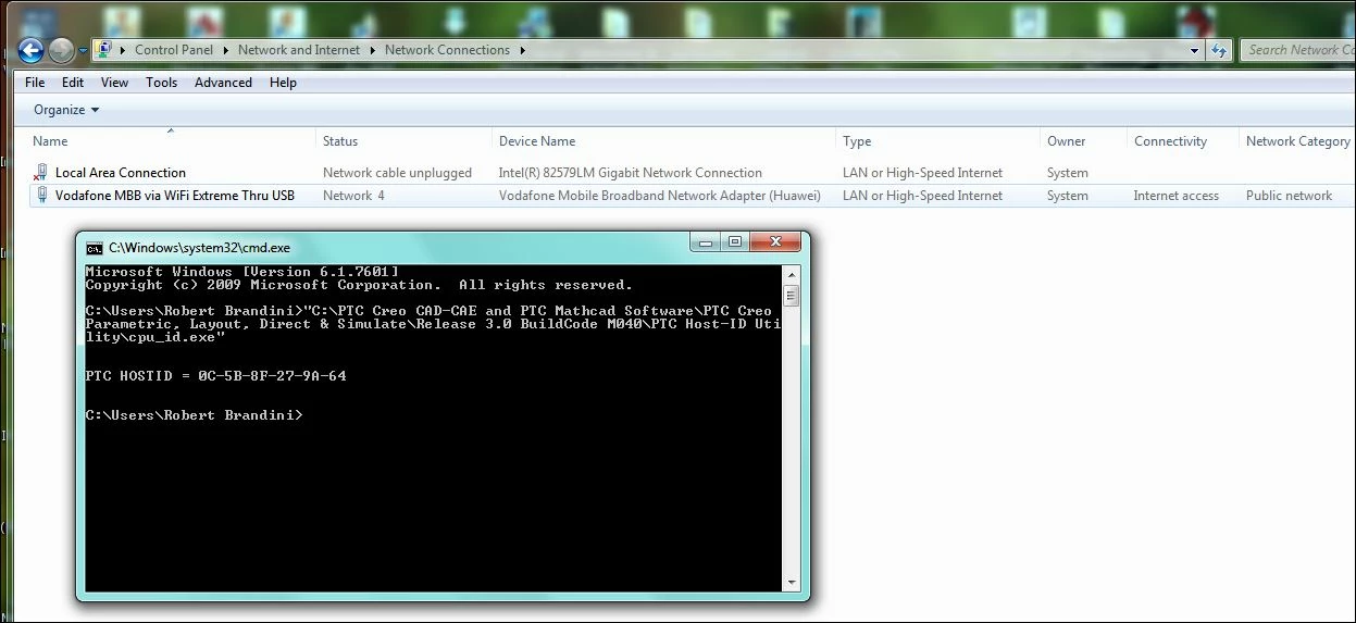

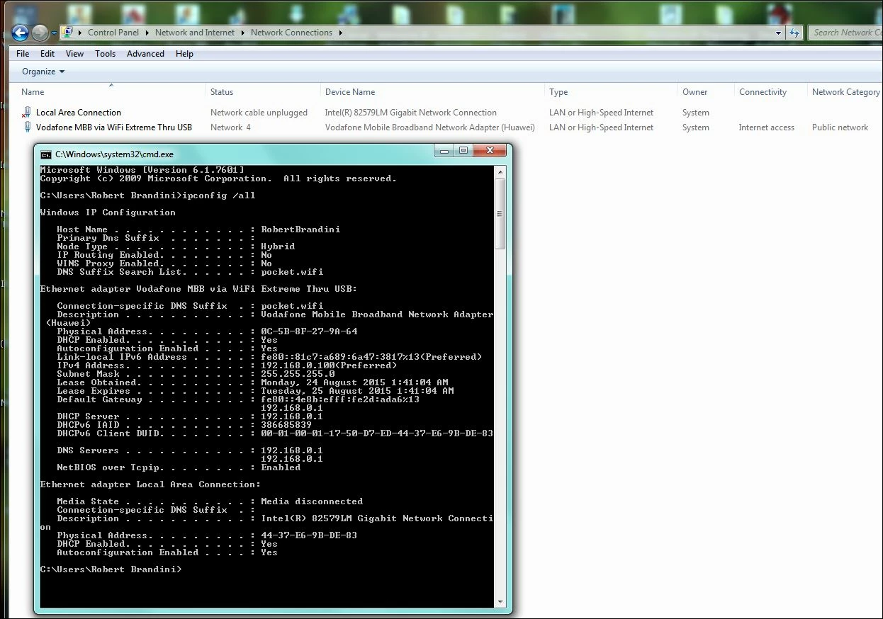

I believe I know what is causing the licence to fail (I think) -> incorrect Host ID due to a temporary internet access modem/connection I was using at the time of installation and license file creation. My normal usual internet connection setup was malfunctioning for a few days so I temporarily made use of my sister's mobile broadband modem connected to my PC via a USB tethering setup. From what I can tell, my license file was generated using the MAC address of this temporary network connection modem as my Host ID. Now that my system is back to it's normal usual internet connection setup, my license fails due to incorrect MAC address/Host ID.
I have an internal "wired" network card installed in my desktop PC which I do not use for internet connection. My internet connection is achieved via a WiFi modem which is connected to my PC via USB (my PC lacks WiFi capabilities so I use this method which works great - except for last week when it was malfunctioning for the first time ever but is now all fixed). --> Please refer to attached screen shots for my standard normal internet connection and network card details & related PTC Host ID's...
