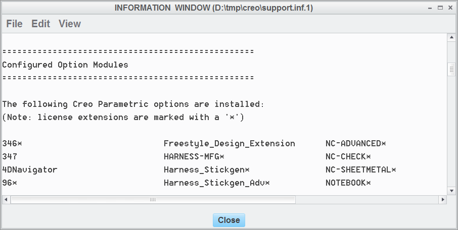

    None of pictures contain licensing information. I guess that you received license file via email. The file is somewhere on your disc, its name is something like *license.dat.
    To see modules included in your license, you can click File > Help > System information and scroll the output (this sequence is valid for Creo 2.0). You will see something like this:
