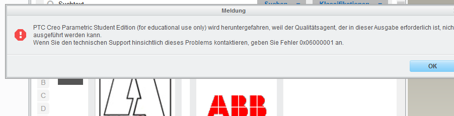

Hello everybody,
Recently I installed Creo 3.0 on my Computer (I have a MacBook, but I run Windows on a bootcamp partition).

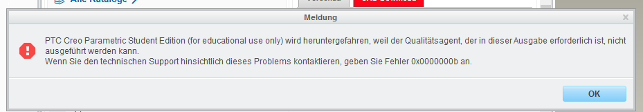

Unfortunately it won't work. Each time I try to start the program there's an error saying the Quality Manager can't run and Creo shuts down(error 0x0000000b, 0x06000001).
As far as I understood, the Quality Agent is supposed to manage the students' license.
The Registration for the license worked well. I use the BK400407EDSTUDENTUNI as license Code.
I already tried to uninstalling and reinstalling everything several times. I tried to do the same with the Quality Agent, but I didn't have any success.
One Thing seems weird to me: I got a mail "PTC License Pack" saying I installed Creo 2.0 - which I didn't. Maybe this is the source of my troubles.
If anybody had a hint, I would be very grateful!
    May 5, 2017
    Just Reconfigure the existing software with the setup without changing anything...
    It worked for me!
