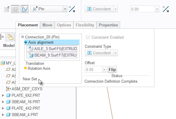

    I'm using "How to Model Almost Anything" with my CAD class and we are on Exercise 6. When we get to the last exercise with the Lego's we are running into all sorts of obstacles. It seems like a step is missing or the tutorial assumes you know more than you should. We are struggling with sliders and assembling all the parts. Do you have any thoughts or areas we can get some more help?

    Hi David,
    I think that your problem is that in the exercise you are not instructed on how to create a second set of constraints.
    Indeed for the Slider you need some instance of the assembly to have two sets of constraints.
    Here is how to add it:
    Pleasse let us know you need more information regarding this exercise.
