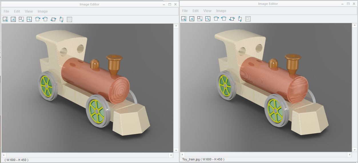

    I am still using Creo 2 so I can give files to schools.
    Just had a quick go and had no problem opening 2.0 Academic files.
    The render seems to work the same way except the render appears in a new window. I tried changing the wood grain direction and scale on the boiler which seemed to work for the two renders below.

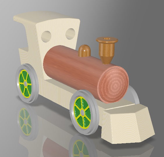

    I think I know what has happened. In Creo 2.0 advanced material textures wouldn't display properly when modelling with the shading with Reflections' option set for the graphics window. They do now, see the screen capture below of the modelling window..
    It seems making advanced textures work in live view may have changed the way proper render works. Is this a case of one step forward to improve 'window dressing' resulting in two steps back for core functionality?

    November 6, 2014
    The larger image of the train was the modelling window without being rendered but with the "Shading With Reflections" option chosen.
    November 6, 2014
    The top two windows were done with 'Render to Window' with 'Maximum' setting.
