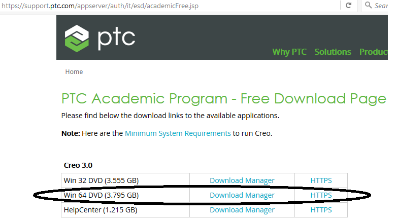

    I got the download from the PTC site here:

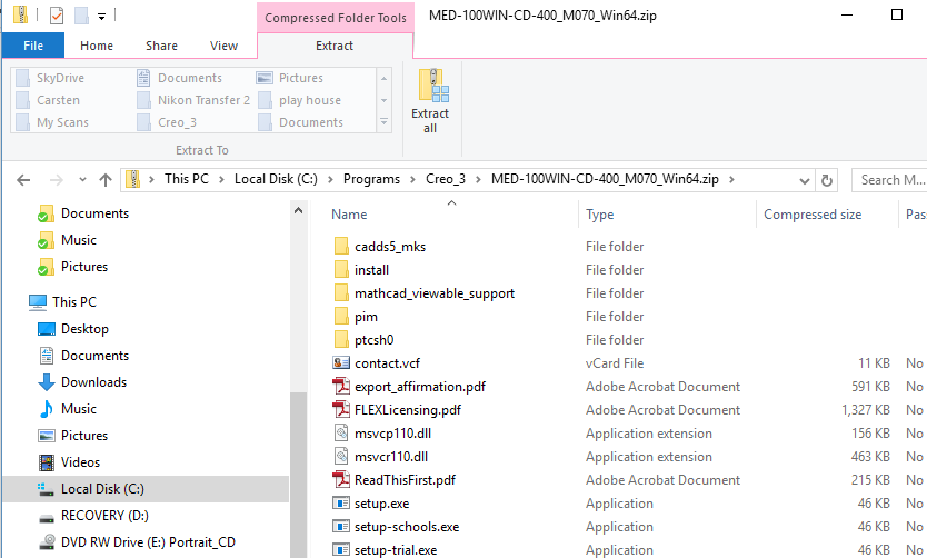

    gheeke1-VisitorAuthor
    October 20, 2016
    I am not sure how to tell what was used to unzip, Windows 10 seems to have a default and that is what was used.  Here is a screen shot
    I clicked the Extract All and told it what directory to put them in.
    I ran the "setup.exe" in the directory above.
