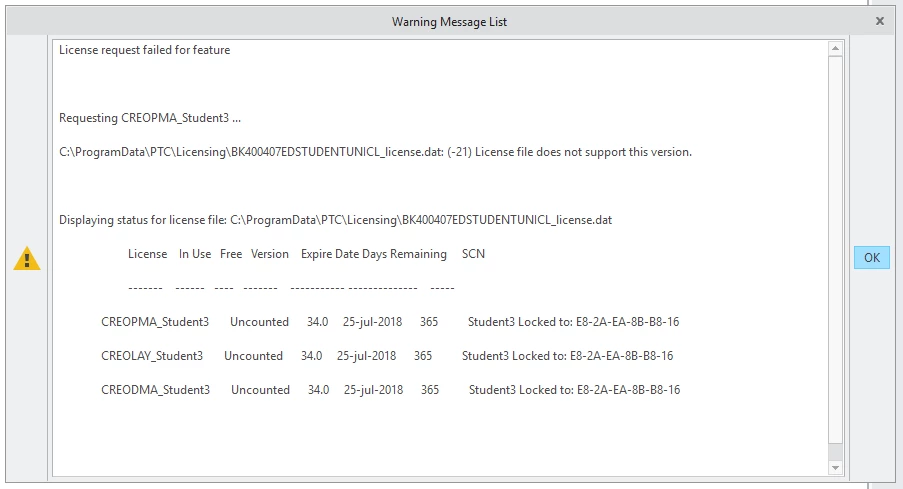

Same issue here, I thought Creo 4.0 would be available but my licence file doen't support that version.
I am downloading Creo 3.0. Do I need to uninstall everything that was included in the Creo 4.0 download before proceeding?
Attached is my error message.

you do not have to uninstall Creo 4.0 if you want to install Creo 3.0. Both versions can be installed at the same time.
On the other hand, I suggest you to uninstall Creo 4.0 because you cannot launch it.
