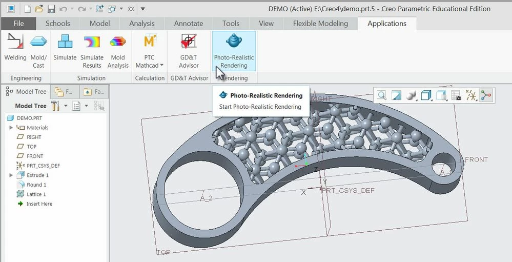

Sep 13, 2017 7:44 PM UTC
We have Creo 4.0 Academic installed using a license server.  Photo Render asks for a license. Could you please send a license for this?
Thank you.
Patsy O'Connell
Sep 21, 2017 8:41 AM UTC
Hello all,
As the new Render Studio is a new extension in Creo 4.0 (no longer the old Rendering tool) you will not find a tab called Render in your Creo 4.0. You will need to access the brend new Render Studio (powered by Luxion Keyshot) from the Applications Tab:
Alex
Oct 9, 2017 12:52 PM UTC
I want to point that only Creo 4.0 Schools Premium licenses (Standalone and Lab) got the Rendering Studio!
For Creo 4.0 Student edition or Creo 4.0 Schools Standard edition please use the View tab, as Explained a few posts ago.
