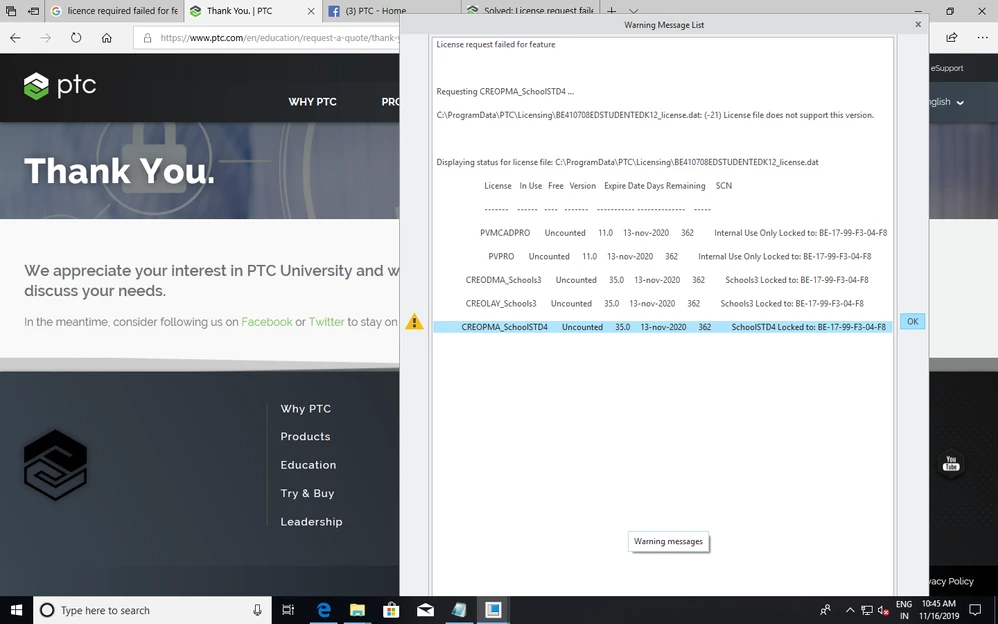

Hello, I'm a university student and I installed Creo 5.0 for students, after opening there was an error message saying license file not supported for this version. Creo exits after I close the error message. I opened the license file in txt and it appears to be a Creo 4.0 license for K12. Please help
Best answer by MartinHanak
did you enter Product code BE500806EDSTUDENTEDK12 during installation ?
Did you follow instructions mentioned in http://apps.ptc.com/schools/references/install_creo5_schools_standard.pdf document ?

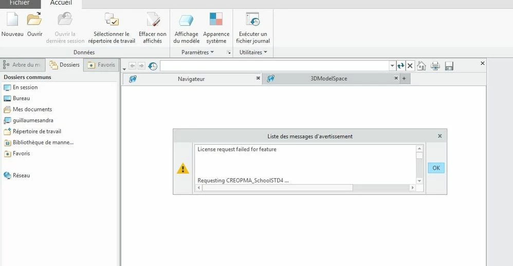

I face the same issue few minutes ago. Indeed I used BE500806EDSTUDENTEDK12 when installing but when I tried to open Creo Parametric it says "licence request failed for feature" (see attached)creo.JPG
October 13, 2018
please enlarge error message window to see the complete information and post it again.

while opening creo 5.0 it is showing that license request failed for feature and license file does not support this version please help me go through itScreenshot (1).png
