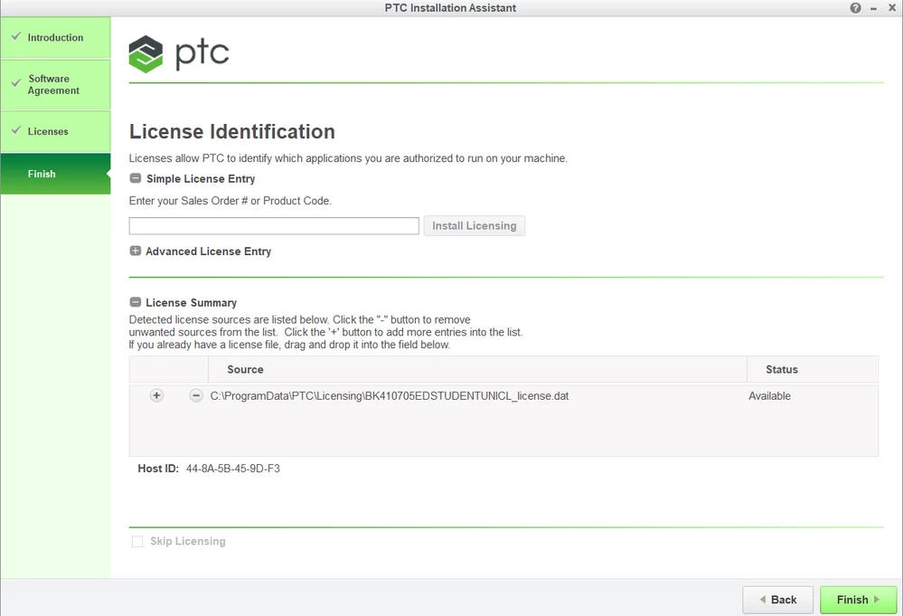

I have deleted all my licenses, open the setup.exe, added the University students Product code BK41070..., close, run CREO and get this error every time.

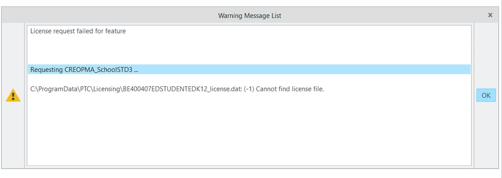

your current license file is ... C:\ProgramData\PTC\Licensing\BK410705EDSTUDENTUNICL_licence.dat
Creo is looking for ... C:\ProgramData\PTC\Licensing\BE400407EDSTUDENTEDK12_licence.dat
You have to go to Parametric\bin directory in your Creo installation and correct information written in parametric.psf file
ENV=PTC_D_LICENSE_FILE-= ... this line must contain path to license file
ENV=CREOPMA_FEATURE_NAME= ... this line must contain license name (see following example)
ENV=CREOPMA_FEATURE_NAME=CREOPMA_Student3 ()

Ok... I have read all the thread here and followed all the directions and the software is telling me that everything is exactly what it is suppose to be. Creo still will not work. I get the license error like has been posted on all the threads. What do I do now? I have reload this software 5 times and nothing works? This installing procedure sucks no directions or anything explaining what to do. Been working on this for 2 days!
February 23, 2018
it is a pitty that you did not attach picture of error message window.
