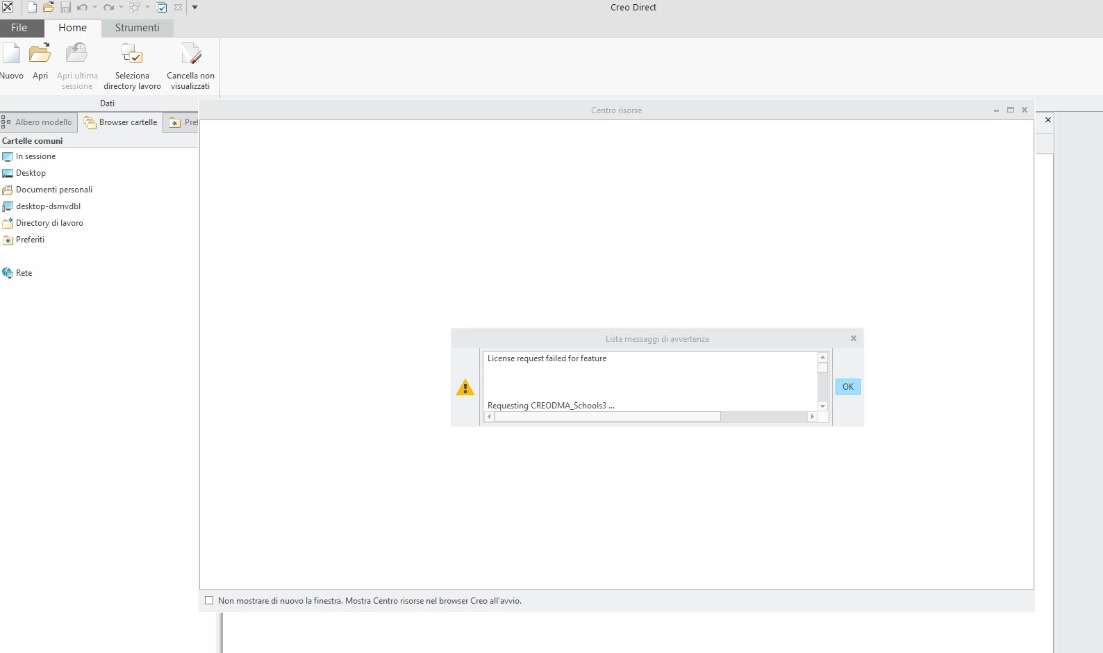

Hi, I have installed creo, via the ptc installation tool,
I didnt have any problem with the license code, in the installation tool
I have correctly installed the programms in my computer
but when I try to launch any of those appliclacion, like creo,
it blocks me to access to the app, because of some issue about the license
but at the installation tool doesnt give me any error about the license that I did use
I have tryed to reinstall the application but nothing,
here is a screen what look like the error that I received for all application:

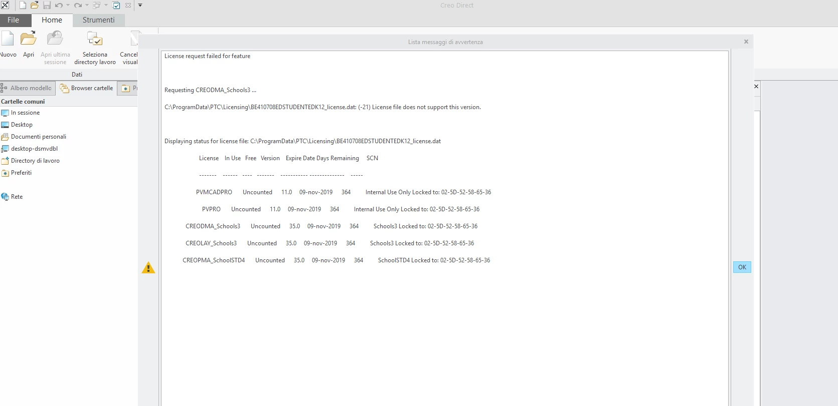

November 9, 2018
please enlarge error message window to display its whole content. Then publish it once again. You can also publish contents of std.out file located in Creo startup directory.

November 12, 2018
1.]
C:\ProgramData\PTC\Licensing\BE410708EDSTUDENTEDK12_license.dat license file mentioned in error messages contains Creo 4.0 licenses (version 35.0).
2.]
C:\ProgramData\PTC\Licensing\BE410708EDSTUDENTEDK12_license.dat license file was generated when you entered BE410708EDSTUDENTEDK12 product code during installation.
3.]
Look into C:\ProgramData\PTC\Licensing folder ... maybe you will find another license file(s)
4.]
Product code related to Creo 5.0 installation ... BE500806EDSTUDENTEDK12
